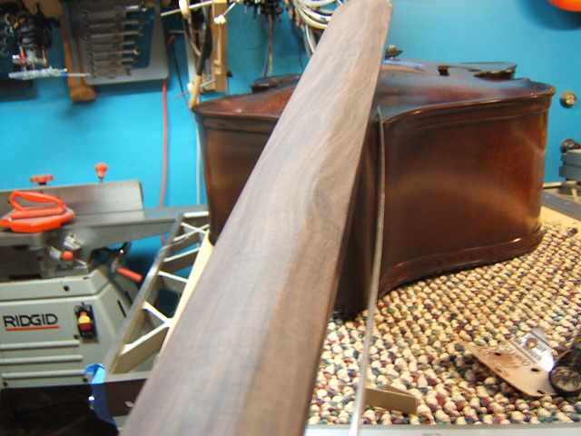

I recently did some work on 4/4 standup acoustic bass. One of those foreign cheap ($1000) models. So I didn't expect the fingerboard to be high grade ebony. Anyway, when I went to re-stain the board with Flebing's Oil Stain (the StewMac stuff) many of the brown grain lines keep bleeding thru. The wood looks to be either Macassar ebony ( I doubt it) but more likely some sort of Rosewood. I have it sanded to 120.
Any suggestions/cures/help would be greatly appreciated!

BEFORE STAIN:

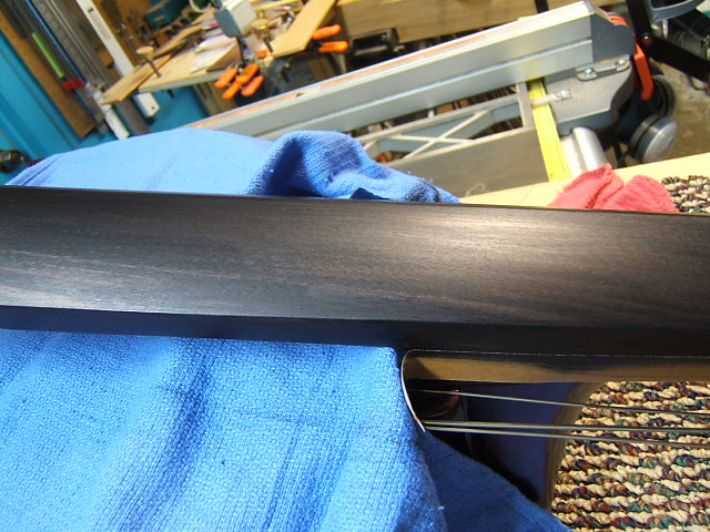

AFTER 4 STAININGS:

Dave, given where you started I think it now looks great! I see your point about some streaks showing through. Have you let the stain thoroughly dry and buffed it?
